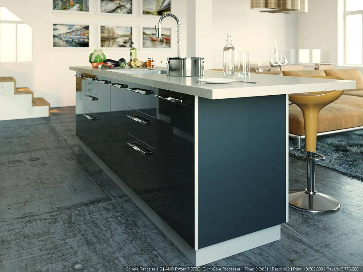

Сообщений: 4
Ryzen 2700x @stock clock and stock cooler wraith prism
3dmax 2018+corona 1.7 hotfix 4
ddr4 gskill sniper X set @3066 mhz cas16-18-18-36
402 pass
noise 4%
rendering 0:24:18 min
total 0:24:31 min
_______________
455 pass
noise 3.77%
rendering 0:27:36 min
total 0:27:49 min
