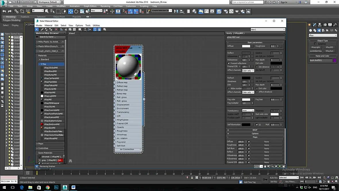

hi show me the material settings
На сайте c 11.01.2016
Сообщений: 6
Blackivan2008 - here ->it's not the first time that i use this setting.. simple white MDF material

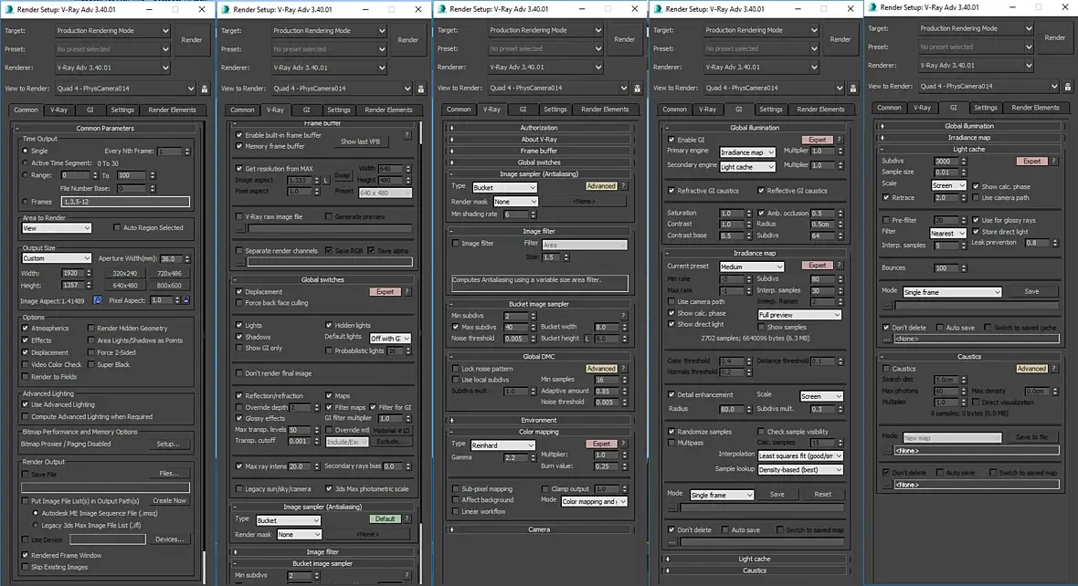

I think it's not a mat problem, but in the render settings. Show render settings. And check the size of the scene.
Сообщений: 6
This is it AndySmitt! :)
На сайте c 24.07.2012
Сообщений: 437
try to use Brute force instead Irradiance map.
