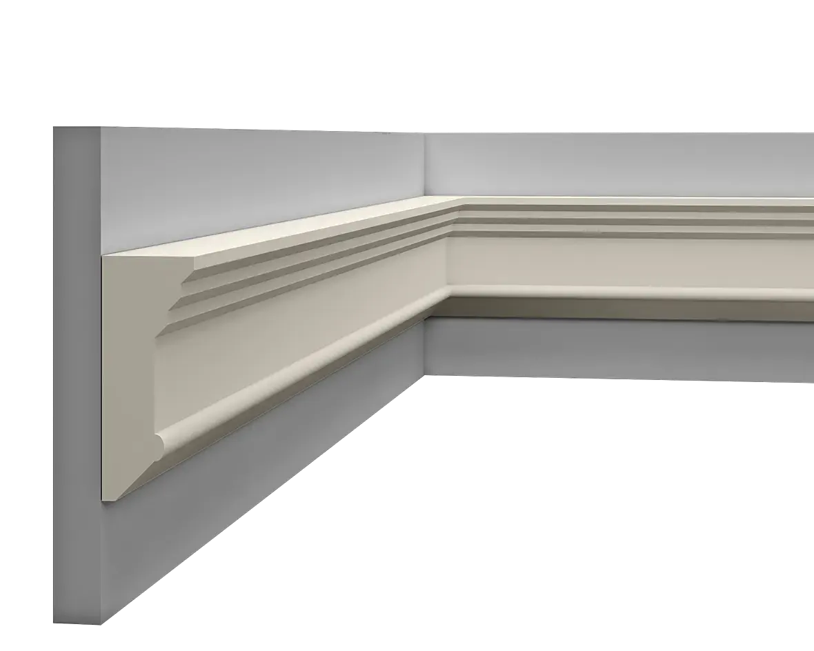

I have a max scene but it doesn't open through the camera.
I really need to recreate the same angle of the camera but it does not come out for me a long time.
I can send the scene to interested myself.

Can anyone help me set the camera on the model that is on google disk and save it to the max scene? Please.
I don't remember exactly, but I think the camera had a film width: 36mm and focal length: 85mm.
Please, somebody help me.
Paypal or Western Union I Pay donat.
The view from the camera must be the same as in the attached render.

My problem is the scene won't open through the camera. The scene is from early 2021.
Цитата alexfmos:
Я не понял снова. Есть две сцены. В одной есть геометрия камера и свет, в другой только геометрия. Чего надо то?
I need a camera at X-height and target at X-height, possibly the target was turned to the left.
Ideally, the camera should be set in the scene with the model I shared.
alexfmos can you do it?

Если я правильно понял то надо это.
У камеры отключен таргет.
позиция и поворт камеры такой.
$.pos = [15.9447,-338.009,58.4558]
$.rotation = (quat 0.671854 0.0262625 0.0289128 0.739653)
