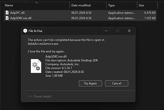

Yes, thank you, I found this post, BUT the problem is that Windows does not allow you to rewrite some files in the bin folder, and removed "read only" and tried to terminate all hitchhiking processes, but they automatically restart themselves
these two files are not deleted or overwritten
In general, with such and such a mother I deleted these files, without them there is swearing and Failed (second line of the log), overwritten from the archive as in the instructions and again twenty-five. In general, it doesn't help... Log in to the autodesk account, well, kamon:)
2026/03/26 15:42:59 DBG: [13088] [14884] ADP Initialize: OptedOut
2026/03/26 18:04:54 DBG: [26552] [28036] ADP Initialize: Failed
2026/03/26 18:05:59 DBG: [23480] [13512] ADP Initialize: OptedOut
2026/03/26 18:06:12 DBG: [22068] [08424] ADP Initialize: OptedOut

Необходимо обновить службу доставки обновлений Access Service или включить ее в службах и обновить все предлагаемые компоненты.

Решено. Выпилил проверку аналитики. У кого лицензия, тот отдыхает. Кому лицензия не нужна, то fix2 в на моём ЯД :)
эм... а где взять этого ЯДу? :)
