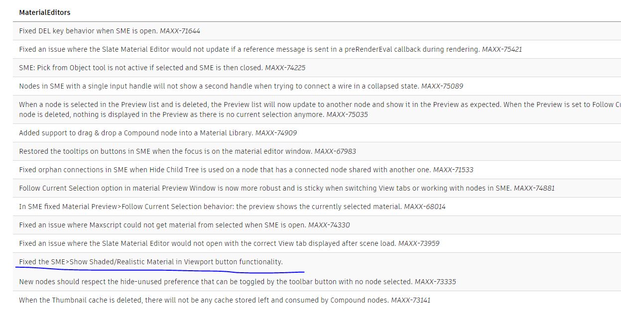

Работает через меню на правую кнопку. В 2024.2 починили этот баг
На сайте c 12.10.2019
Сообщений: 253
А учитывая, что патч вышел только вчера... ноэнэлэмщики терпеливо ждут :)
Кстати, в патчнотах не нашёл этого багфикса

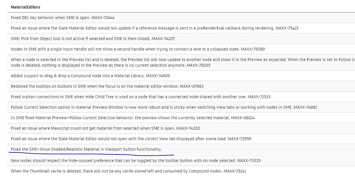

An update on this problem.It happens when a bitmap is assigned to multiple materials. When clicking on the button, the menu does not appear thus it's not possible to continue. When single-assigned, this menu is not displayed and the functionality is correct.We have a fix that will be released in a future Max version.
The problem with Show Shaded Material in Viewport is fixed in Max 2025. The issue was not fixed in the 2024.2.1 Hot Fix. The bug is on the menu that allows to chose which material should be affected by the change, that is not triggered in Max 2024 and its updates, only if the same bitmap is applied to 2 materials, or if a Multi/sub material is involved.
