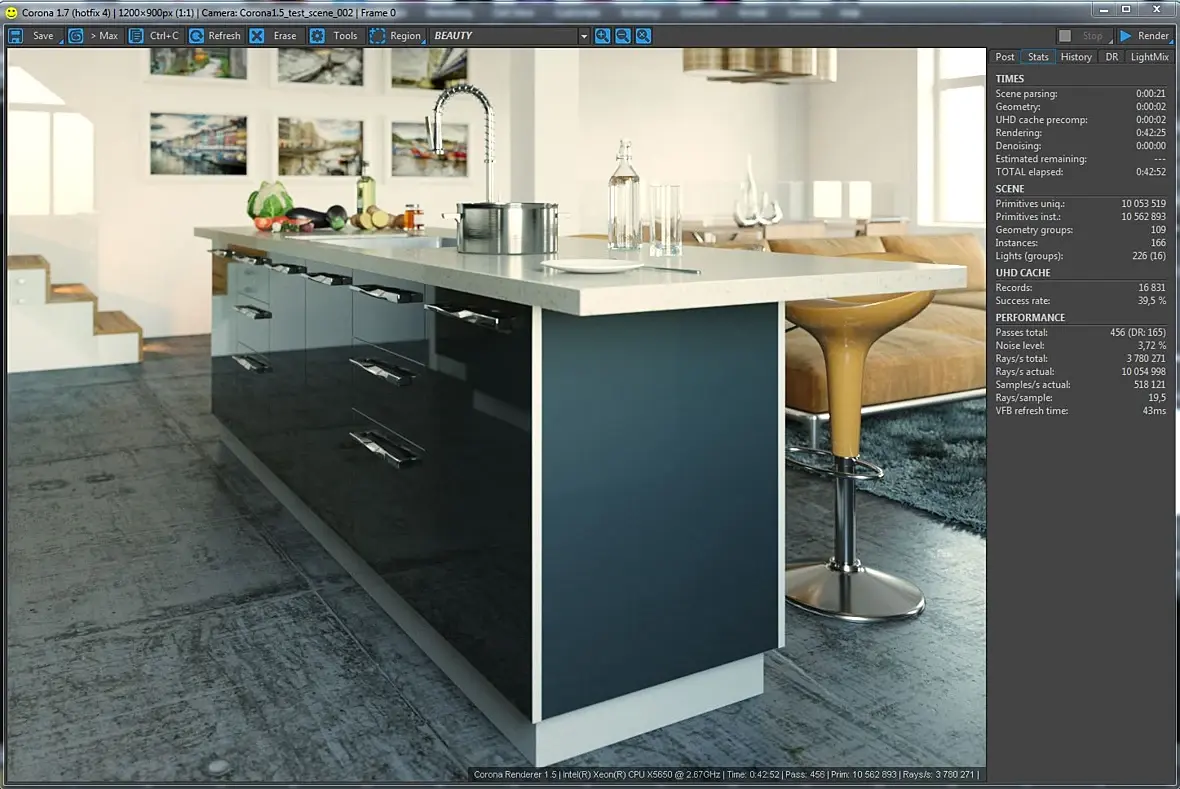

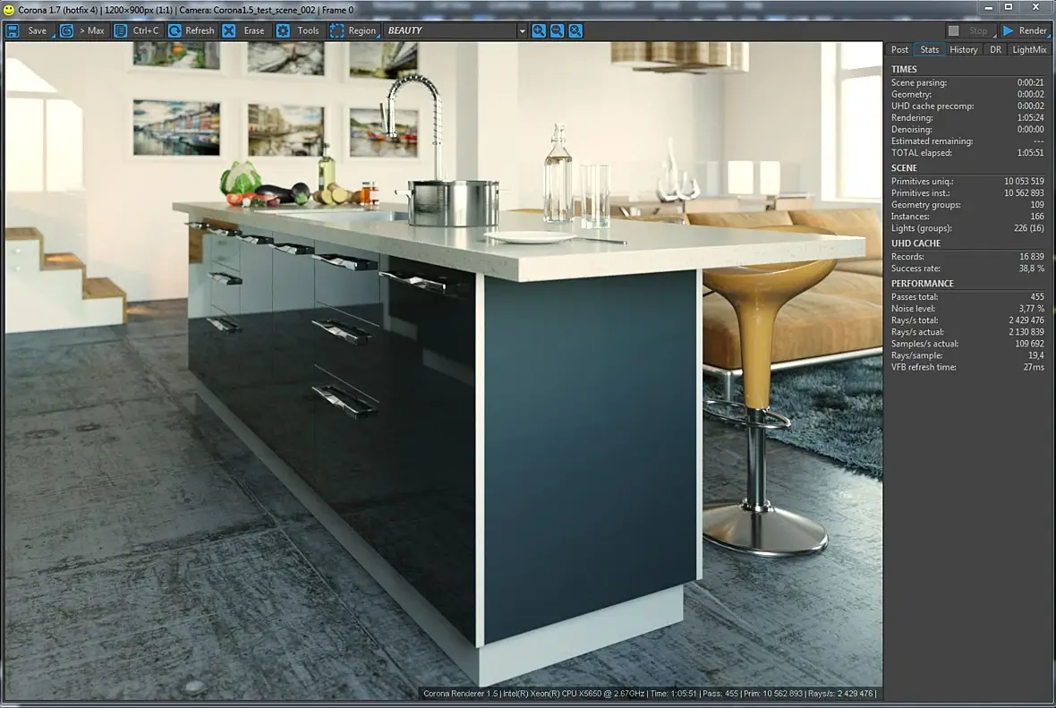

Абакан
мах 18 + Корона 1.7 (455 pass)
Xeon X5650 @ 3.74GHz (22x 170)
time = 1h 05m 51s
Xeon X5650 @ 3.74GHz (22x 170) + i7-930 @ def
time = 42m 52s
